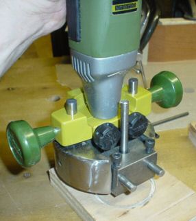

Nelson -- Glad you like it! I forgot to mention about the nose. As you found out it's 20mm round, unthreaded. I also bought the Proxxon OFV router base which fits the rotary tool. The router base itself is a nice piece; but for different applications I remove the yellow top part of the base (the part that clamps around the tool) and use it to mount the tool to something else. In the image below it's mounted to a different base I made to rout very small circles. I ordered 8mm diameter drill rod from McMaster-Carr to use for the rods that the piece from the router base mounts to.
